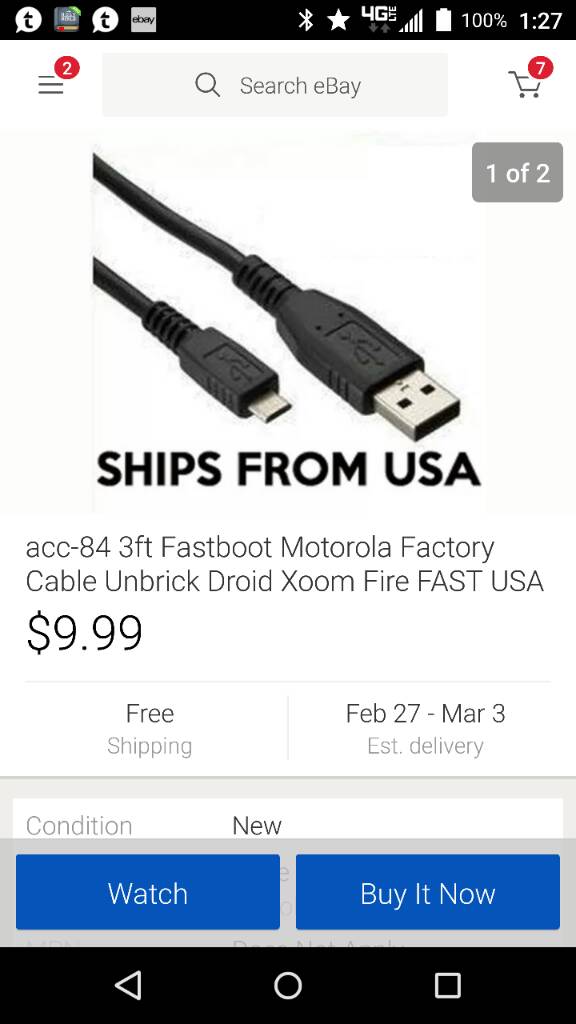

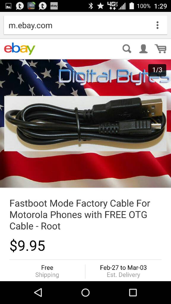

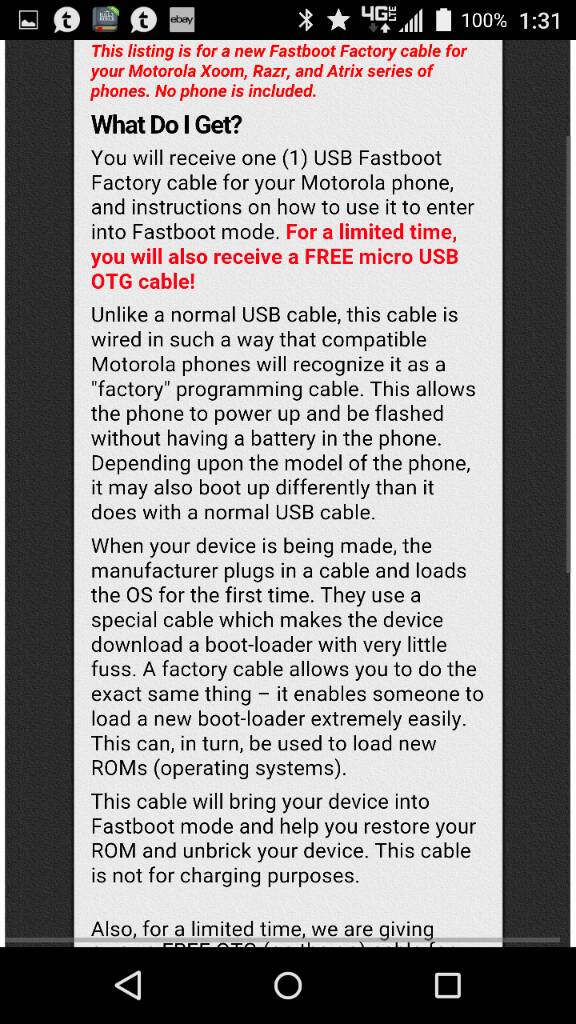

    Here are two factory data programming cables that will allow you to fastboot and flash a ROM even with a dead battery or no battery at all. The second one also comes with a USB OTG cable allowing you to connect external USB hard drives and thumb drives for backup storage.
    [​IMG]
    [​IMG]
    eBay
    [​IMG]
    [​IMG]
    eBay

    Be wary of charging the lithium ion battery on a "universal charger" unless it's specifically designed to charge LI batteries. Charging those batteries incorrectly can result in overheating and eventual rupture and hot flaming gases.
    In fact it's recommended to only use the Factory Data Cable for as long as it's needed to obtain a working operating system. Since it dumps the full current and voltage of the charger block directly to the battery it bypasses all the safety features of the built-in charging system and doesn't meter or adjust charging it, therefore it can also result in overcharging and a ruptured battery. I generally recommend no longer than one hour initially followed by one or two half hour periods maximum.
    To be 100% safe, disconnect the battery completely and use the cable as the only source of power while flashing the ROM.
