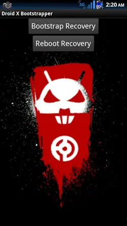

The Bootstrapper
Koush's Bootstrapper is a tool used to boot into clockworkmod recovery. You can make a custom image of your phone, install roms, etc. all from the recovery menu.
After downloading the .apk above, install it after browsing to the file on your sdcard.
In order to do so you must allow 3rd party sources to install apps. Turn this setting on in:
  • Settings -> Applications -> checkmark 'Unknown sources'
Make sure you're rooted, then load up "Droid X Bootstrapper". Press Bootstrap Recovery (it will prompt for superuser access and then say "success"), then Reboot Recovery (it will also ask for superuser access, then reboot your phone).
Your phone will reboot into the clockworkmod recovery area - this is a crucial thing to get used to if you're going to play around with your phone.
