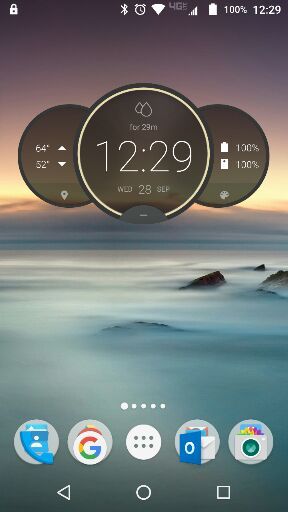

Fully charged! I'm really curious at to whether it's a software issue or hardware..
