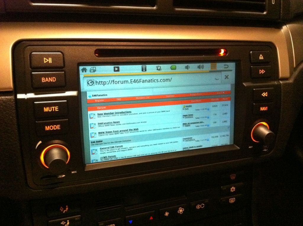

Wifi TETHERING:
The Dynavin E46 Android works with a USB Wifi antenna (included from me, dont know about the other vendors) to tether to a wifi hotspot or phone with wifi hotspot capability for internet/data access. Similar to the existing Dynavin windowsCE wifi hack but minus the hack part.... Dynavin will also offer a 3G modem that will require an additional data sim card with its own data plan from your cell carrier. Just like an android smartphone or tablet, access to the internet is necessary to make the most of the unit.
One VERY important note: apparently many android devices dont support "ad hoc" wifi connections, the dynavin is one of them. While your home wifi and most mobile phones use "infrastructure" wifi, I found that my jailbroken iphone 3GS running the Mywi app DOES NOT. Since it is an ad hoc wifi, android doesnt see it and I cant tether to it. The iphone 4 DOES provide infrastructure wifi.....upgrade time for me! DO NOT assume your phone has the right kind of wifi hotspot. Confirm this BEFORE you buy an android dynavin or be prepared to change phones if necessary

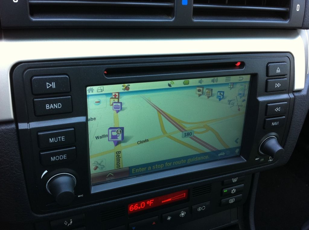

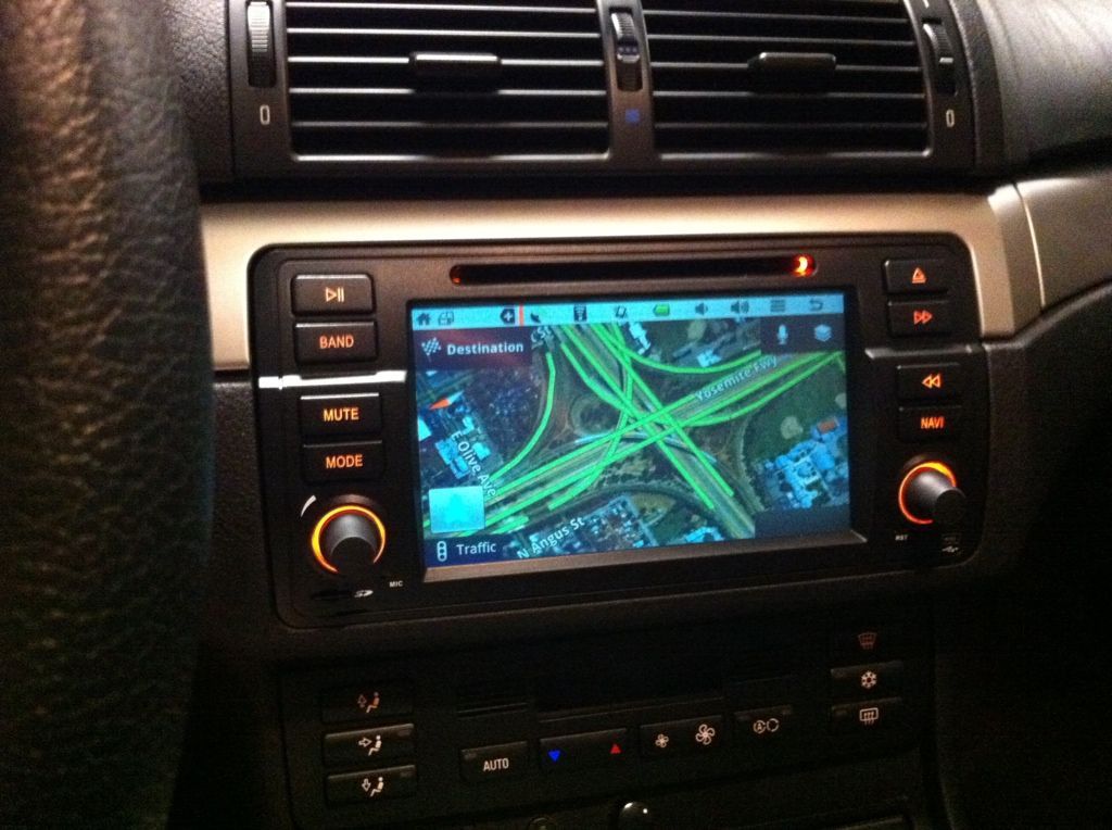

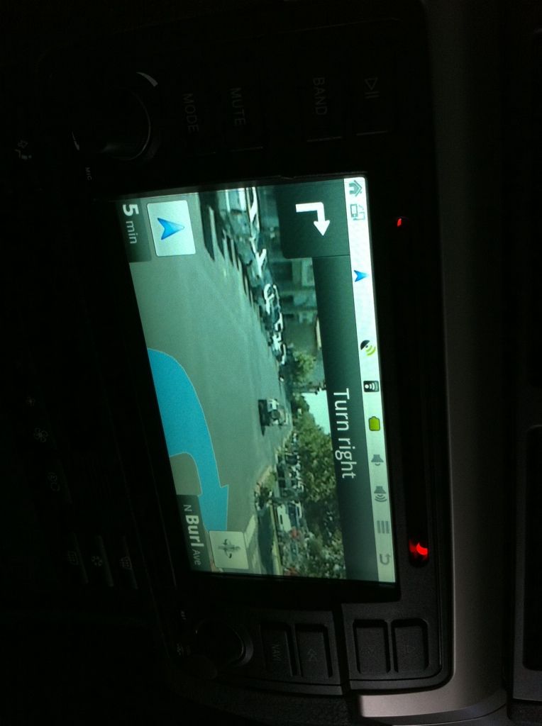

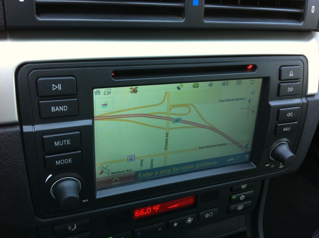

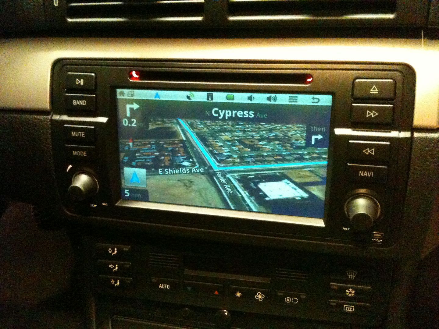

NAVIGATION:
Android runs google maps for navigation which in this application is a great program.
Plus the inclusion of Google "places" and "Street View" integrated with Navigation takes in car GPS to the next level...
but just like on your phone, it needs internet access to run, you will need an offline navigation app to make it a TRUE GPSsystem, plus its a little much to deal with while driving. Because this is Android there are many apps available and this choice is being left up to you.....
I tried out the Copilot Navigation app and found that it works well on the dynavin and is an offline map solution. Its not as pretty as google maps but it will work for those times when you are not in cell range. You download the app and the maps (you can download the maps on the dynavin or your computer). This isnt rocket science but you do need to have a working knowledge of computers and androids app download process to make this happen however.
The Android version of the dynavin uses the same touch screen as the windows version, so no multitouch. Its got zoom buttons where necessary.
Gestures however need to be deliberate as this is just a standard automotive style resistive touch screen, dont expect ipad type response! I find it works best if I use the edge of my fingernail for gestures.....finger tips are fine for button presses.

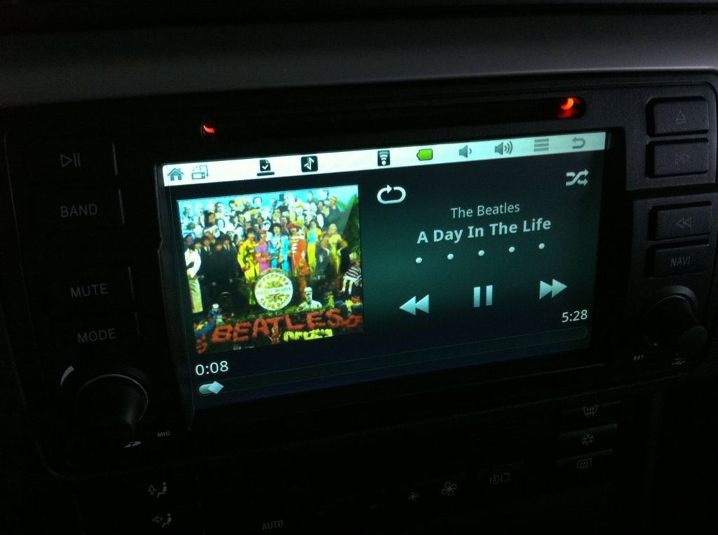

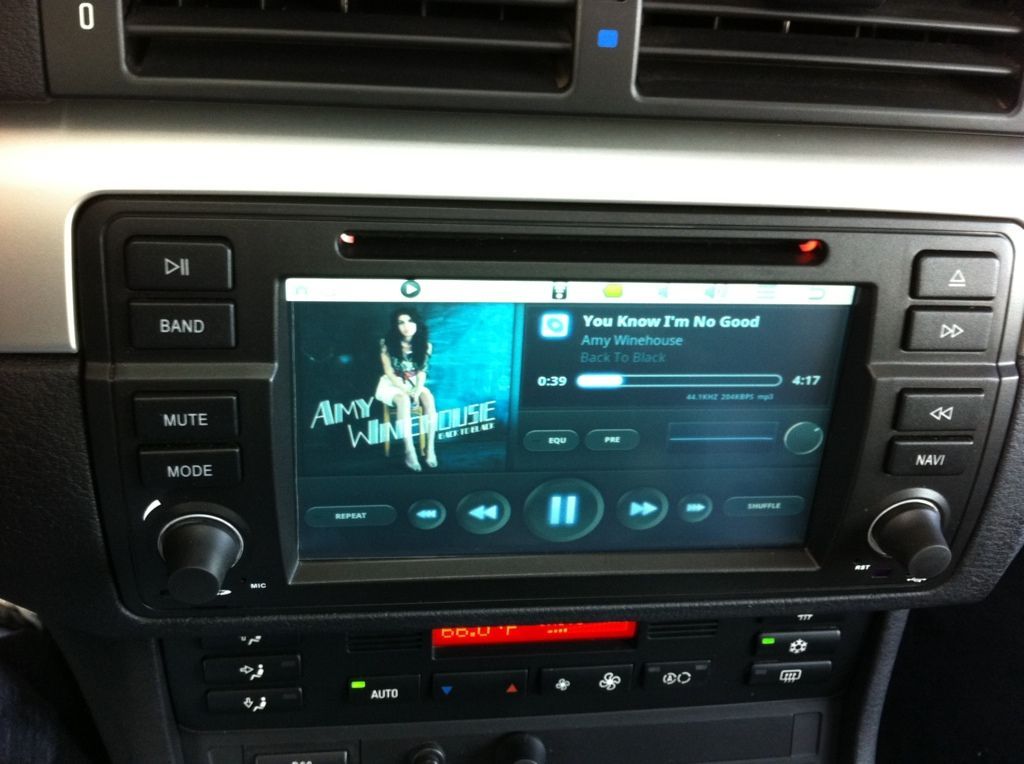

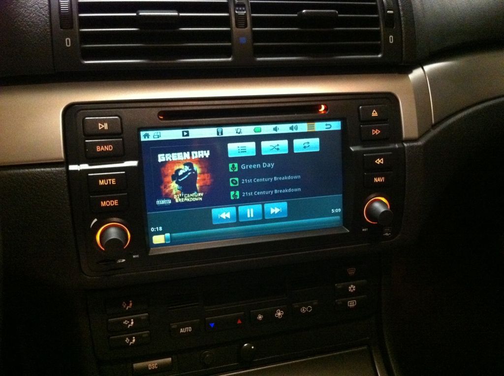

MEDIA PLAYER:
The standard Android media player is pretty good.....better than the other music player options on the dynavin. Album art, artist, albums, songs, playlists. Nice. The only downside is androids default color scheme of black, dark grey, medium grey makes for a really washed out display in daylight....I really had to crank up the screens contrast to have good visibility during the day. The dynavin already has its visibility issues, dark grey letters on a black background dont help.
There are other media player apps of course so you can select whatever you like....Ive tried out a few others as well....this is "Double Twist"
And PowerAmp

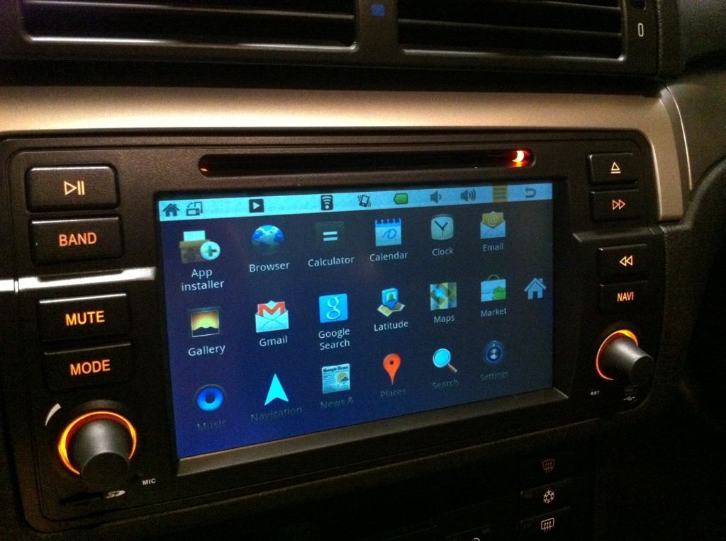

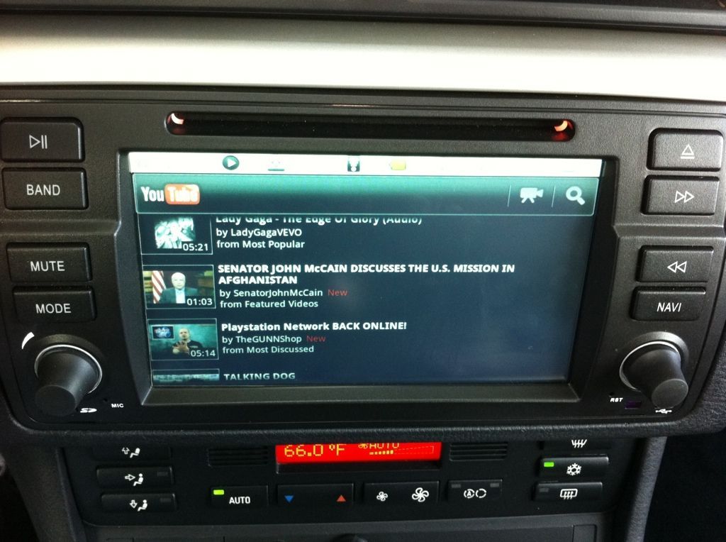

APPS:
There are of course an endless supply of apps but here are a few that people are enjoying:

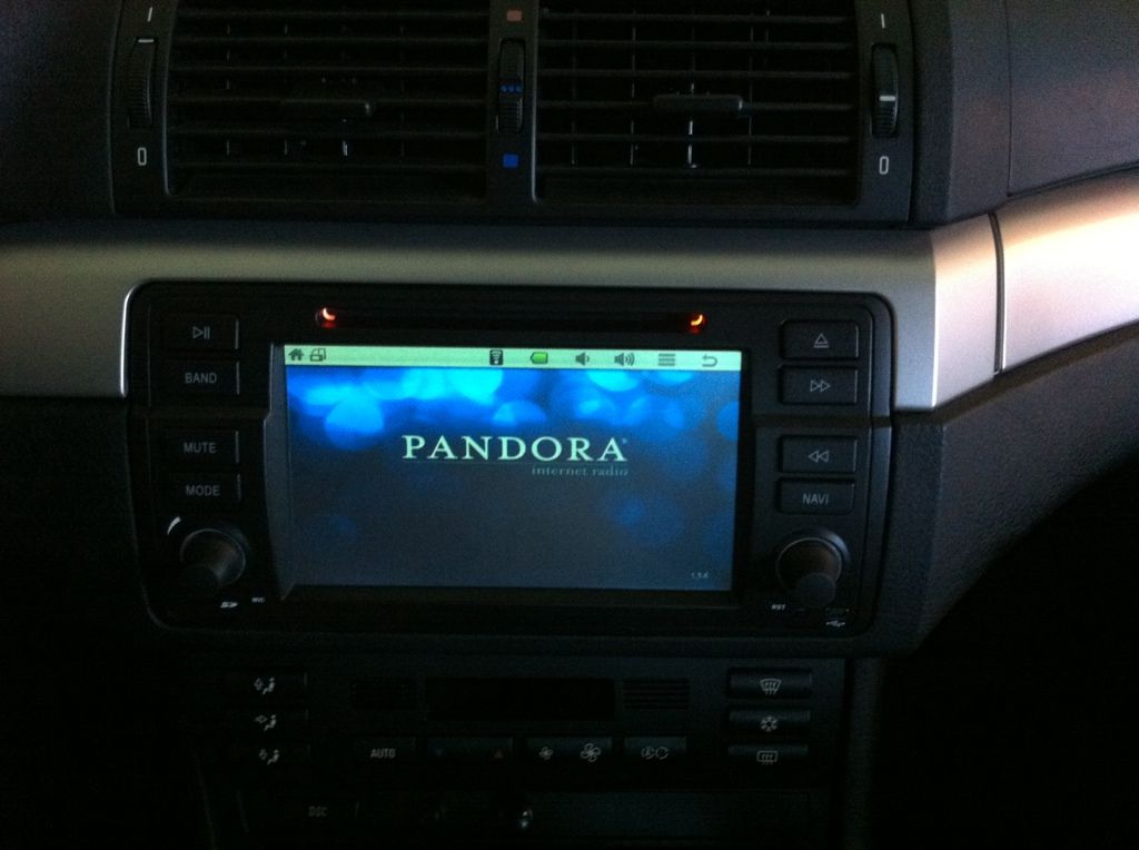

Pandora

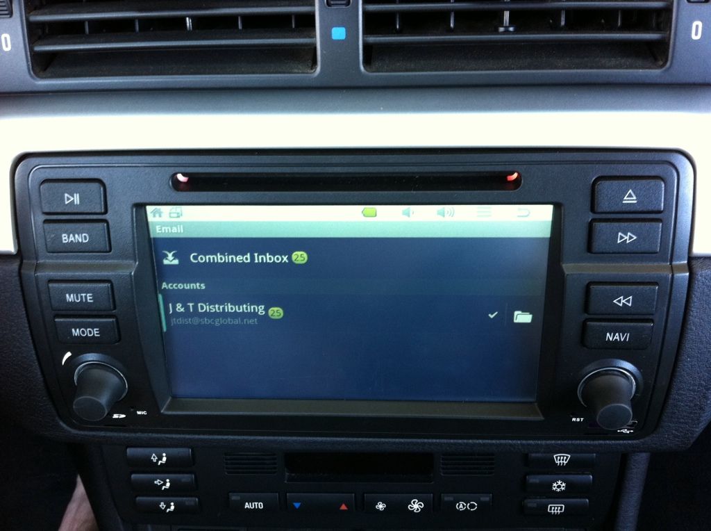

Email
Youtube

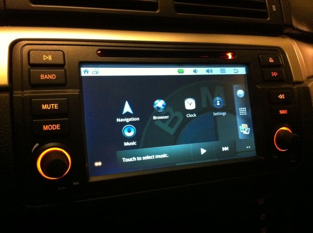

4: Now to access the android side of the unit you will use the NAVI button, it will toggle back and forth between the radio side of the unit and the android side. Almost every app on the android side has its own volume control that is controlled by the volume icons on the status bar at the top of the screen, if the volume settings for any given app are too high the sound will be be distorted, turn them down to a moderate level for best results.

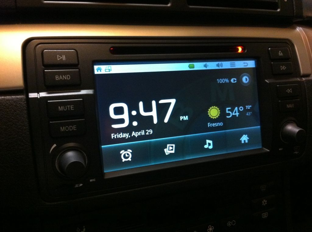

5: The android part of the unit gets its time settings from the GPS receiver, in the time and date settings you will need to uncheck the "Automatic" time option in order to set your time zone but be sure to recheck "automatic" before you leave this menu so that it will continue to automatically get the time data from the satellites.
