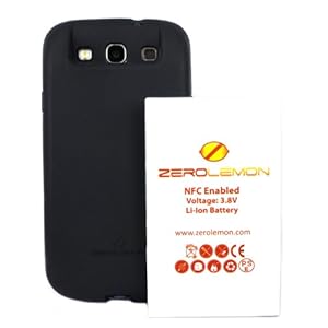

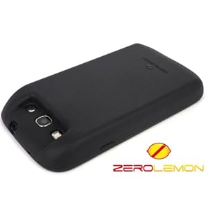

This is pretty much a huge battery with an Extended TPU case that Hyperion and Qcell sell on the side for extra 6-8 bucks. The way they acheive larger capacity i'm assuming is that they take full use of the back of the phone physical dimension (in areas such as where microsd is, the battery overlaps it). That's very unique approach that I have not seen another one else has done so far. Since the case covers the battery anayways, you will not notice these throughout regualr day use.
THICKNESS
There is no back hard back plastic cover like the Hyperion one as the extended case does the job in securing the battery in place. A thing to emphasize is that the thickness is literally the same as the Hyperion battery + the extended case or even slightly thinner as there is no hard plastic cover to add the extra thickness. In fact, how they hold the battery is by using the tpu case edges to secure the battery which is quite ingenious. I tend to have problems with those hard plastic covers used by hyperion because it doesn't secure properly and dust goes into the gap. With this zerolemon battery, the problem doesn't exist since there is no such gap.

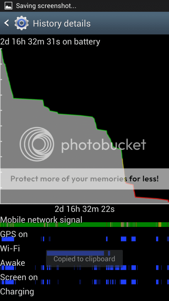

FINAL RESULT
-Battery finally finished by 12pm with 2d 16h 32m total use
- 13h 33m screen time on the battery at medium brightness (I set it back to medium brightness even when the battery is at critical level)
- GPS on for 10h and 36m
All this and not a single charge during the weekend. This is the weekend warrior battery I've been looking for. Hyperion does ok but dies usually by Sunday morning.
One interesting thing to note is that when the battery is at 3%, it will stay there for relatively longer than usual. I'm guessing it's the phone's OS not able to calculate the battery percentage correctly being so big of an battery.

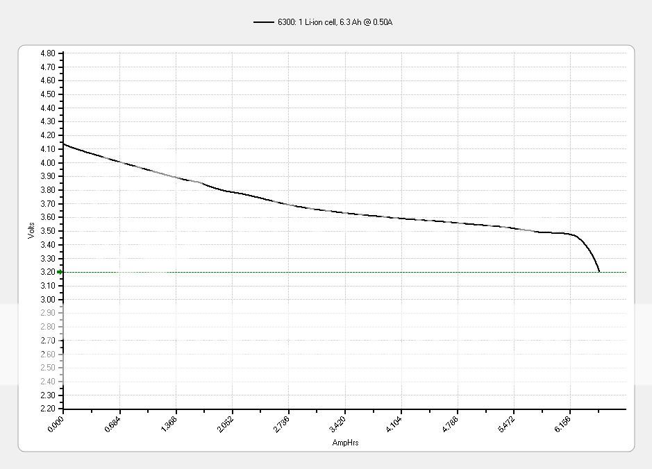

This battery seems to do even better than at 6300mAh capacity. I threw this battery in my CBA tester tonight to check the exact capacity and post some results once it's done
UPDATE on CBA test:
The battery is rated at 6510mAh and below is the graph. Very good stuff

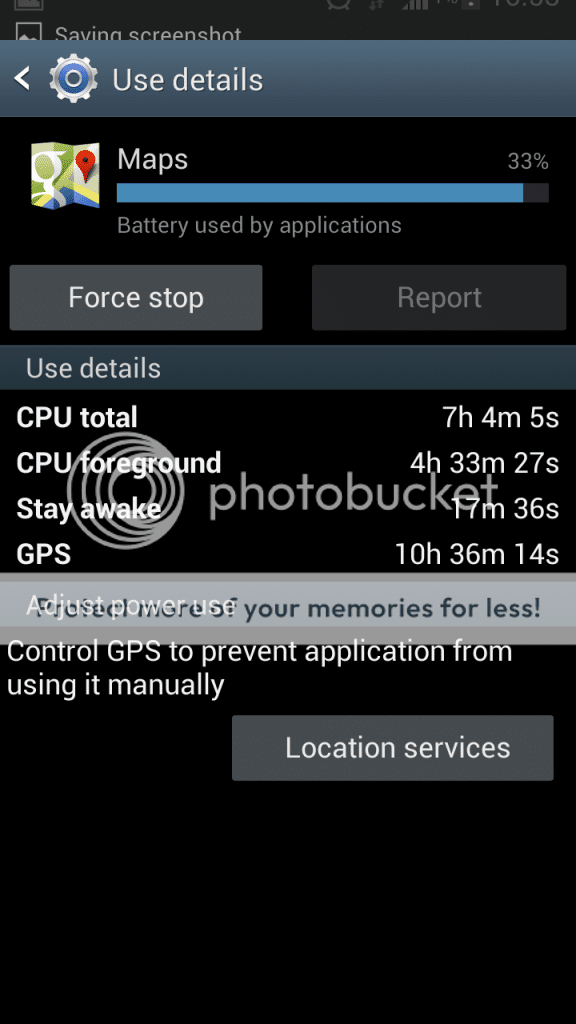

UPDATE JAN 21st - After Lake Tahoe snowboard trip with very heavy use of GPS
just confirmed this is truly the monster I've been looking for!

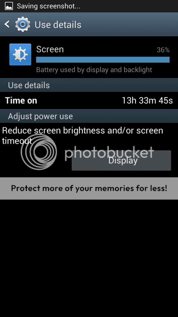

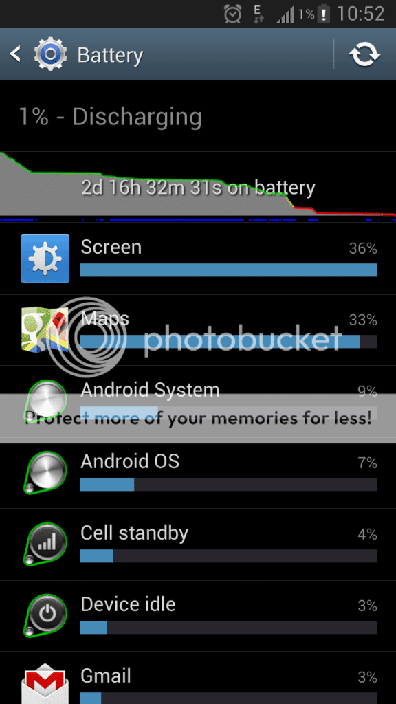

FINAL RESULT
UPDATE on CBA test:
