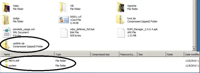

ok well in that case i didnt do any of that pasting in a folder. its all direct. lemme give u guys a screen shot of it
here are 2 screen shots, one of the data on my phone, the other is the update.zip opened up

you are unmounting your phone/sdcard from your pc before you try to install thru recovery, correct?? when you say "data on your phone", do you have the update.zip in your data folder? i would also double check and make sure you don't have it named "update.zip.zip".
other than that, you may want to boot up, go into Rom Mgr, flash CWM recovery, and then flash back to SPR (or just try and flash using CWM).
