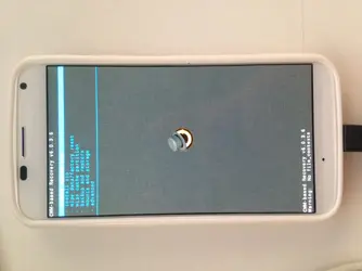

Custom CWM 6.0.3.6 with F2FS fixes.

Unofficial CWM Recovery 6.0.3.6 for Moto X --- 8/25/2013 WORKING!
