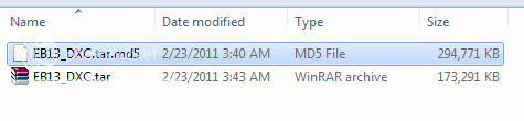

RIGHT CLICK AND SELECT EXTRACT HERE THE .rar file AFTER DOWNLOADING AND BEFORE USING(How to extract in post #2) -->EC16SC29_DXC.tar

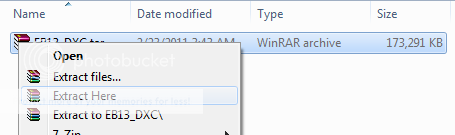

Extracting a compressed file (ex. zip or rar)
1.) Download and install Winrar HERE
2.) Locate the compressed file you would like to extract
3.)Right mouse click on the file icon a drop down menu will appear , select Extract Here
4.) You will then see a progress pop up window that will appear then when completed will close itself
5.)This will leave an extracted file in the destination folder
Congrats you have successfully extracted the compressed file it is now ready for use

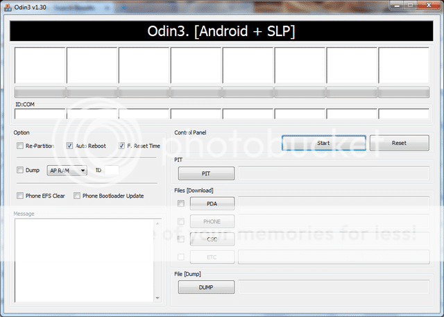

First you must download
Odin v1.3
Once odin is downloaded open it, its an executable file so when you open it you will see the following :
Once this is up, do the following

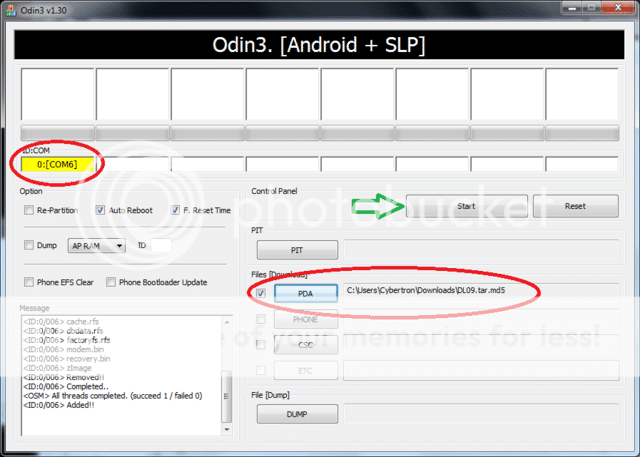

-Remove the battery from your Device
-Plug in the USB cord
-Hold down the Volume Down button until you see a big bright triangle on your screen , underneath it will say Downloading and beneath that it will say Do not turn off target
At this point you will see one of the boxes in the corner turn yellow, letting you know there is a connection
after you are connected you want to hit the PDA button, NEVER PHONE, phone will erase your modem and you will have trouble connecting after that at all.
when you click the PDA button a pop up will appear and you will need to select the file you would like to flash and then click open
now you will see the file appear in the PDA window....with connection made and the file in the PDA window, you may now hit Start
Once you hit start this process Should take approx. 5 mins if you are returning to stock . shouldnt take any less time than that and not much more. So dont start freaking out at min 2...(wait till min 7) lol
If you are flashing a Clockworkmod file it should take approx 7seconds.
Once it says finished/reboot it is safe to unplug , put your battery in and boot up..
