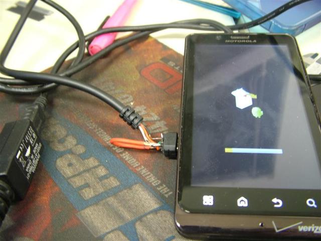

Yeah. All of I've got (that are sacrificable at the moment) are micros... Got it all opened up. The how-to on here shows a mini. So it looks substantially different. I'd have to say tho, there's only one unused tab. So I guess just jumper that to the red. I'll let ya know if I make any smoke!
Well, she worked. The cable is janky as hell... But she powered right up and appears to be completing the updates.
Although it kinda keeps going back and forth between the Motorola Dual Core Screen and the little file transfer screen shown here
That settles it, now i can't justify $25 (digs for exacto and pile of old cables) now if i can just find one that has the pin 4 tab intact
What's probably happening is it gets enough power to bootup, starts to bootup and then realizes it needs to update. Update process begins and the battery dies.
Just as an update, it took a while and did get the updates done. All is well in Bionic world for me.
