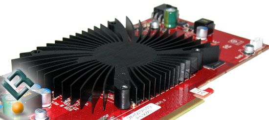

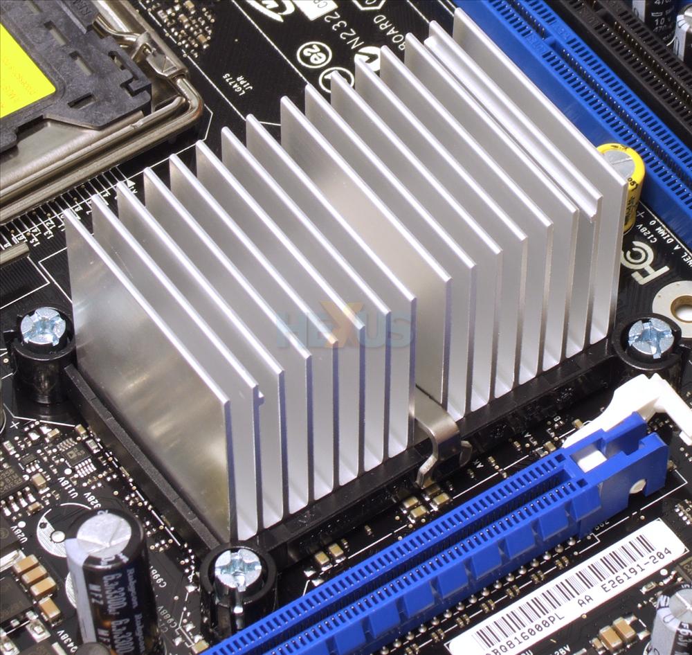

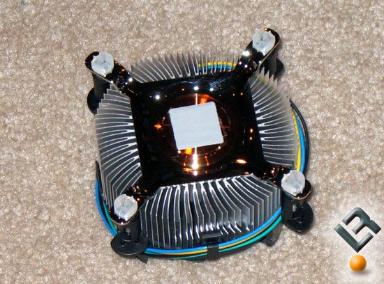

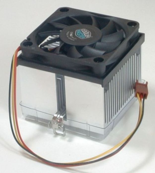

Also, make sure you clean the dust out from between the fins on the heatsinks positioned on key board components, processor, coprocessor, video accelerators, etc. See images below. Essentially anything that looks like a comb type metal apparatus is a heatsink. They are typically made of Aluminum and can be delicate and prone to bending so if you can, use the brush attachment, and NEVER do any of the above while the computer is plugged in.
