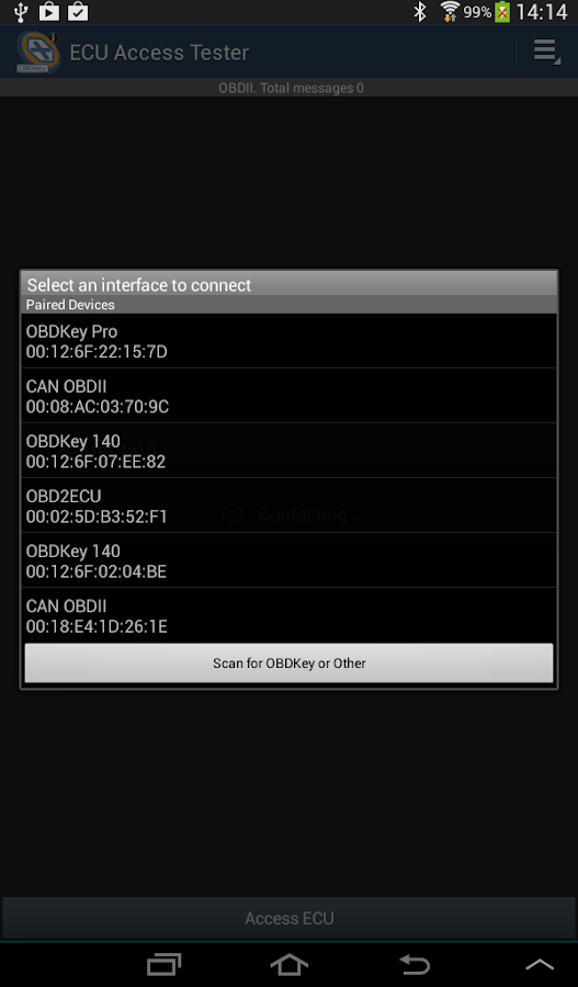

I tried this and got connected to my ECU using a Samsung Galaxy.
https://play.google.com/store/apps/details?id=com.kbmsystems.ecuaccesstester&hl=en
