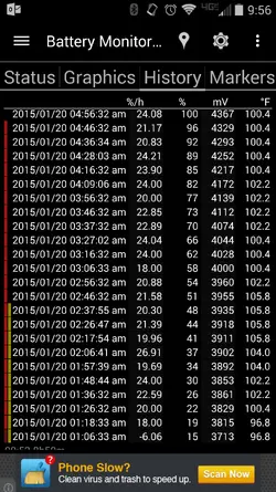

On my wireless charger:

Do you know what peak temp the battery gets up to with that wireless charger? I stopped using my charger when I saw the temp get up to 114 deg.... I want to preserve my battery longevity for as long as possible.
So after some testing the Wireless Charger I the temperature high I've seen is 106 (rounded).
The Turbo charger makes it hit 105.
Are you sure that is the battery temp and not the phone temp? It seems quite low for a wireless charger. My battery reached 107.5 on the Turbo charger. I suppose that can be a factor related to ambient room temp.
Battery Temp. No doubt.
Did you click my link in post #38?
Now, if the program isn't accurate, I have no clue. I always thought you had to have root to get this info, but apparently not?!?!
