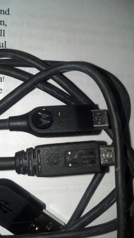

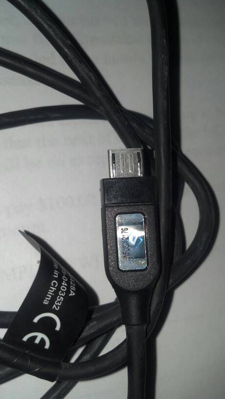

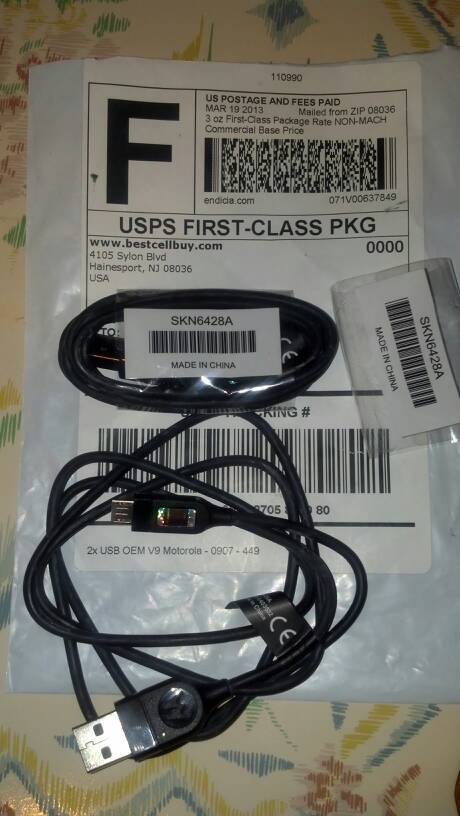

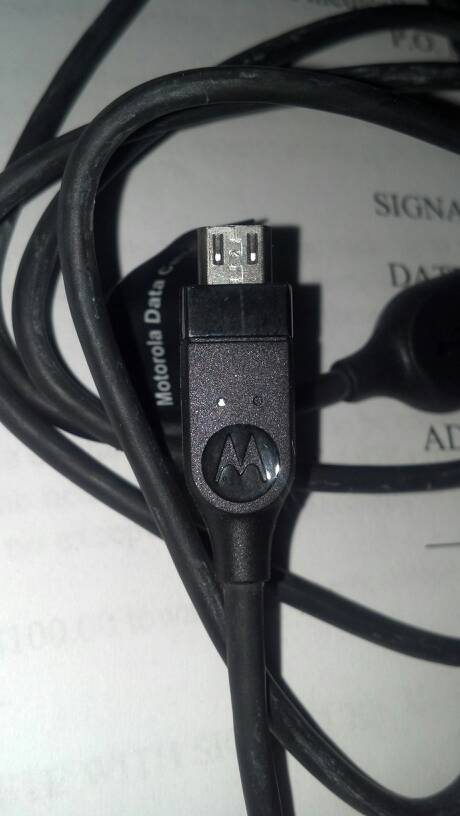

As a result, in order to have extra cables around the house/car/office, I've purchased these from eBay (very inexpensive and they work for both data and power) - OEM USB Data Sync Link Cable for Verizon Motorola Droid Razr. By the way, I made an "offer" of $6 for both and the offer was accepted...the cables arrived today in the mail! See pic below. You'll notice the MicroUSB end has the hologram label, and the USB-A end has the Motorola logo molded into the plastic. Also, the cable has the model #SKN6428A. I am connected to my PC this very second using the cable in the picture and it's both charging and I have access to the SD cards from my PC desktop.
These cables are different than the one that came with my phone. The stock cable that shipped with the phone is a thicker cable, and it's a plastic sheath which is stiff and not very forgiving when bent. The ones I received today are thinner and more flexible, and the sheath feels more like rubber than plastic. Also, at the end where the MicroUSB connector is, the cable enters the back of the connector and it's very well protected from flex, whereas the original cable has a "strain-relief" molded in which really doesn't work given how stiff the cable is.
