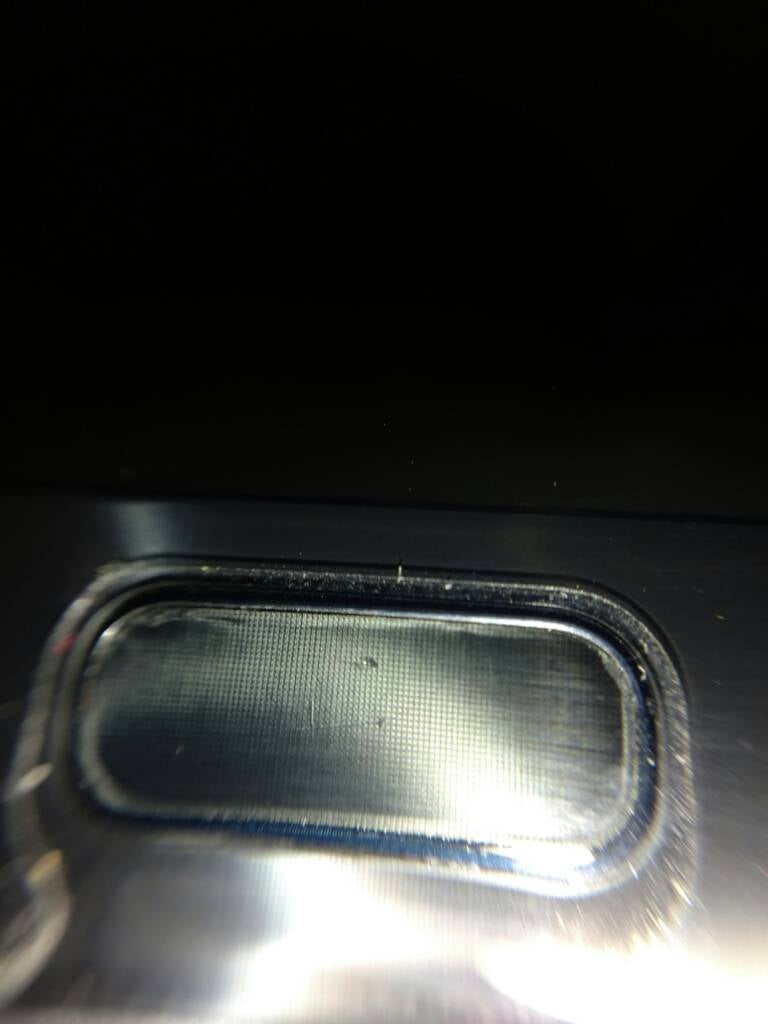

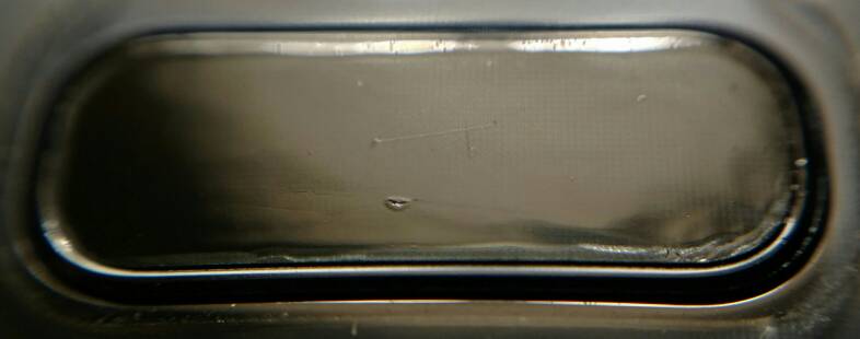

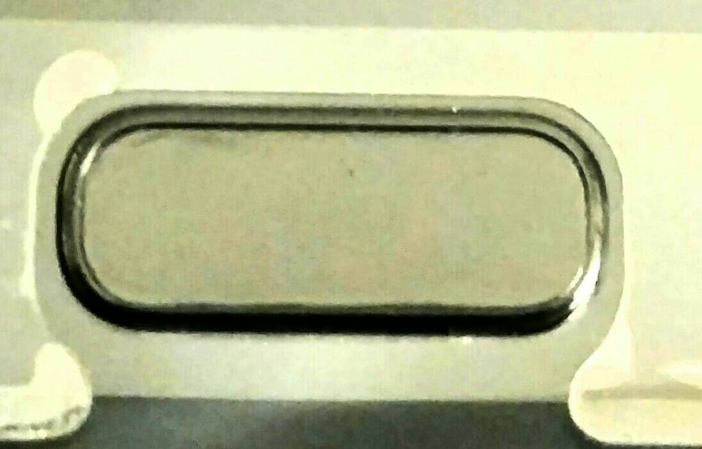

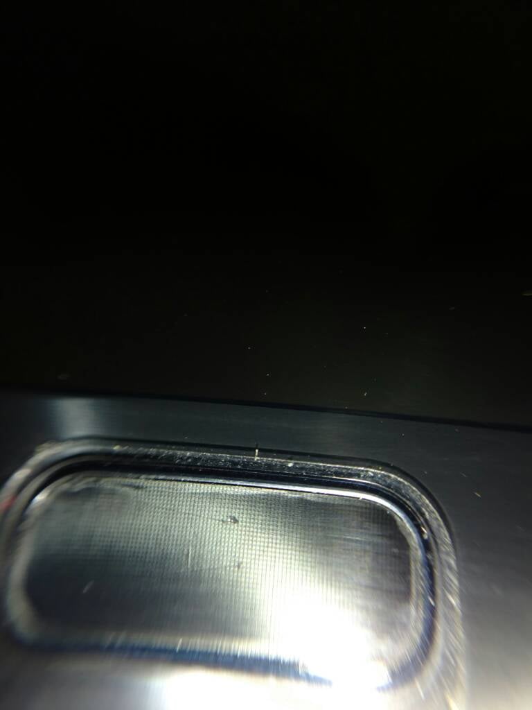

OK, so what started out as ugly is looking much better but it's not done yet.
Here's how it looked originally.
I decided to try a car clear coat scratch remover.
This is a bit thicker than I would have liked. It didn't flow and self level as well as I had hoped but it's not bad for the first coat. You'll notice all but the very deep scratch are essentially repaired and at first glance it looks pretty good.
You'll notice a bit of an uneven edge at the bottom right of the last picture. This is because it is thicker and so I couldn't get it to flow evenly without going over the bezel edge. In the pictures above the button is right side up but this last photo is upside down.
Still I have to do a second coat to fill in that big nick and scratch. Hopefully I can resolve that slightly uneven edge I mentioned. I may try to dilute the clear coat with additional Toluene try make it flow easier.
The recent pictures are with a macro lens and the last two are with the flash set to torch.

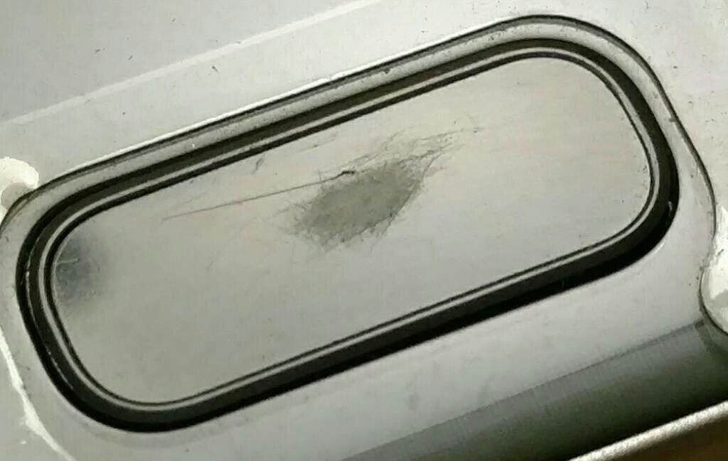

my home button of the replacement device after two month:
BR slowmotion2016
