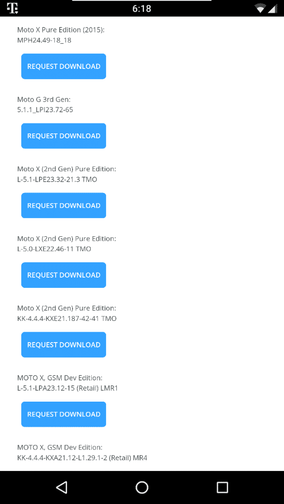

This is what I used for my Moto X. Wasn't the pure edition though. Maybe this might help. You can sign in with your Google account
https://motorola-global-portal.custhelp.com/app/standalone/bootloader/recovery-images

I'd make a folder on your C Drive, name it something easy & unzip the files I linked to there. It'll make things easier later. Holler if you have any questions
