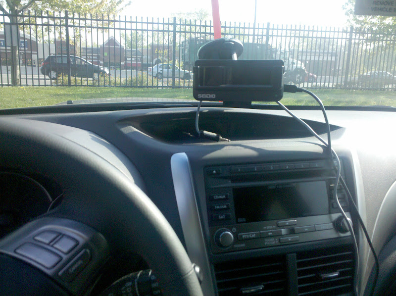

that looks pretty cool and also allows me to hook up i-pod and sattelite radio which has been in my trunk for months.

sure :) i should mention tho that it sounds REALLY good when you don't have it charging. when it is charging...at times you hear some static. it's just intermittent tho and i have no complaints.
