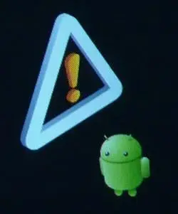

Hi everybody. I got my Thunderbolt the first week that it came out and have loved it. I rooted it and loved it even more. Then these Verizon update requests kept coming in and coming in. I rejected them and planned to keep doing that until the other morning they forced it on me. The update failed because the phone was rooted I assume. Whenever the phone tried to install the update and reboot I keep getting the android next to an exclamation point. I then press menu and go to clockwork mod and it has a list of options. I've tried them all. My latest, last resort has been to factory reset the device and sign in all my accounts just so that I have a phone. I even formatted the SD card hoping to get any update files off for a normal reboot. Verizon is still pushing the update and it still fails to install every time, giving me the error image:

Are you flashing those files through hboot? I have used jcases unroot method and it worked flawlessly.
OR you could just install the stock (rooted) OTA ROM and that should resolve the problem too.
I was trying to use Jcases unroot also and didn't realize or remember that you have to hold volume down and power at the same time to enter hboot. I read through the replies to his unroot method and figured it out. So, I'm back to the stock ROM but the update still fails. The message I get now is "download failed." It doesn't try to reboot or anything. At least now it is back to stock so I can talk to Verizon about the problem and have a stock phone with no trace of it being hacked. Any ideas why the update won't install or what I can do? Also, if and when I get the update installed can I root it again? Thanks.
Not sure why it wouldn't be able to download the OTA. Did you flash both files? The first unroots and puts you back to a stock ROM/recovery, and the other installs the s-on bootloader. Although, I only flashed the stock ROM/recovery file once and i was still able to d/l & install the OTA with the s-off bootloader.
