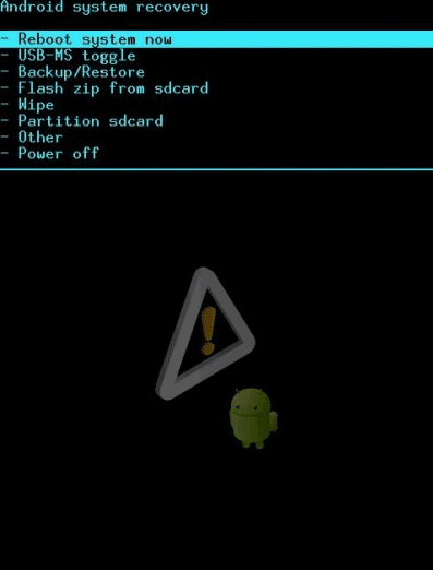

#2 Wipe Cache
While the phone is booting up hold the "x" button on the slide out
keyboard. You should see a screen with an exclamation mark and
an android. Now hold both the volume keys. It should show a list of actions.
Using the volume keys navigate to wipe cache and hit the power button
to select. This usually fixes the CM7 bootloop.

#4 Factory Reset
This will wipe all your data (anything not on SD card) so this
should be done with caution. To boot into stock recovery hold "x" during bootup. Then
you will see an exclamation mark and an android. Hold both volume keys
and you should see a list of actions. Using the volume keys navigate to
wipe data/factory reset. Select it with the power button. It should proceed
wipe your phone.
