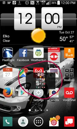

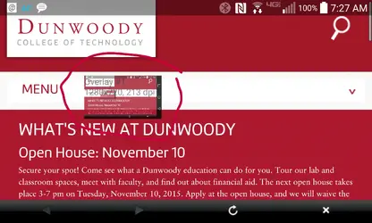

I have a LG G3 I just replaced the screen on. When I powered it up the is a small copy of the screen that appears on the screen and it won't go away. It is always there no matter what screen or app I am in. QuickMemo _2015-10-27-12-00-47_resized.webp
Any ideas on how to get rid of it?
Is it a duplicate of the screen you are on or always that home screen? Where did you get the screen from? Why was it replaced? What kind of damage was done to the phone? Looks like a hardware issue to me but we need more information

Something either went wrong with the device hardware other than the screen breaking, or something...
My thought is there is something wrong with the main board in the phone.... I would contact the seller with the above photo and see if they would be willing to send a new set up again to rule that out... Check all cables and connections inside the device is another thought.......
