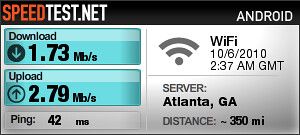

I have a Linksys n router and EarthLink broadband that averages 18-22Mbps down and 10Mbps up on both my laptop and gaming rig.
No matter what I do the fastest I can get my Fascinate to run is about 1.6-1.8Mbps down and, get this, about 3Mbps upload.
What am I doing wrong? Shouldn't I be really smokin' on both up and down on WiFi?
By the way, my router is about 5 feet from where I have done a lot of my home surfing.

Here is one of the tests
After a ton of research and troubleshooting I fixed my issue.
Turned to be an easy fix. Changed a router setting and BANG, fast DL. Had to set wireless from mixed to either "G" or "N" only. For some reason "mixed" would confuse the phone and limit it all the way down to 1.5Mbps DL.
