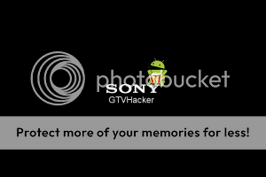

The process in the guide above will walk you through downgrading the system to an exploitable version. Then using another exploit, we hijack the devices boot process and reload a new kernel. This completely bypasses the signatures normally used by the system, including those used in the bootloader, kernel, and init binary. The kernel reload process happens automatically each time the box is powered on, and the USB drives required for the install are not needed again. After loading our attached unsigned kernel you will notice a new splash screen (featuring the Sony and GTVHacker logo) as well as the following perks:
