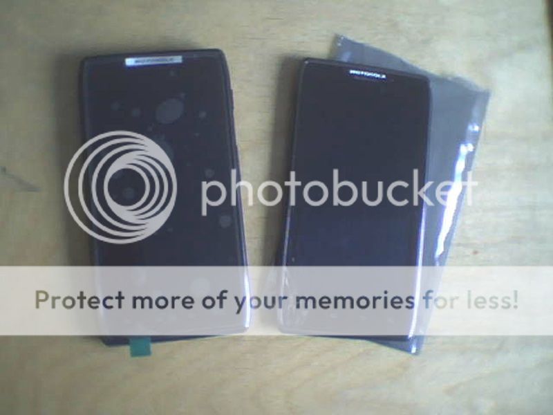

and now I got a new, unbroken screen :) So Xt910 and Xt912 parts are compatible with the Xt908 (as I expected). The phone rear case is a bit different so the replacement procedure is a bit different from the one in the guide, but it's all doable. Check the result yourself:
The only visible difference is the Motorola-Logo in the top, which was black with silver writing, not silver with black writing. That might be a color-specific difference, not a model-specific one (the new display + front frame was for a black model, i'm not sure but I think the old one was for a silver/gray one).
