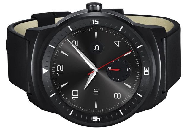

Why do you need to root your LG G Watch R. Obviously all the things need to be rooted! With super user permission you can mod your device and add functionality that you wouldn't ordinarily be able to add. Root and TWRP are now available for the LG G Watch R. To root you will need a bit of adb knowledge and the adb and fastboot files setup on your PC.
