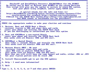

2, 3 Combo
Allows you to root and forever root with one script
http://rootzwiki.com/topic/5484-r3l3as3droot-and-43v3r-root-for-the-bionic-v21/
Run R3L3AS3DRoot.bat

If you screw up go back and use this to get back to stock with Super User on Cheesecake
New Version
http://rootzwiki.com/topic/5484-r3l3as3droot-and-43v3r-root-for-the-bionic-v2/
