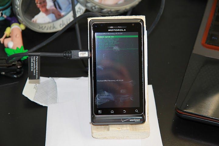

When you first booted into CW or Bootstrap, whichever you used, did you get a screen that looked like this?
If so, was there an option on the first menu you came to for a factory restore/wipe data? Probably was the 3rd option. That's the one you wanted to use.
