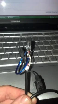

Okay, here's what happened. When I started out with Safe Strap I flashed the newest Gummi ICS to the safe system, which got stuck in the boot animation. The battery was at about 80-90% at this time. I went to do a nandroid restoration to get back to the functioning system as it was. This is where I messed up the boot loader and got stuck in the Fastboot loop. At first the battery was OK, but once I found your sticky the battery was now low. I ended up making a factory cable, which involves sacrificing one of our micro charging cables. Cut down to the wires at the micro end, find the red power cable (I think it carries the +5V), splice it with a new wire before it reaches the pin, then solder the splice. Finally, solder the other end to the unused pin on the micro tip (number 4). I used a short section of speaker wire as the new wire because it was what was readily available. Here's the forewarning, the wires inside the USB are tiny. They are easy to break the wire themselves, break from the pin (I did twice and had to re-solder), and require steady hands. And if you cross the wrong wires you can royally screw up your phone or computer.
For a good resource, check this: here
What this cable does is when the Droid 4 powers on and discovers that pin 4 has the +5V on it, it bypasses the low power. It's the same thing they use in the factory so they don't have to charge the battery to program. Once I had it made, I connected the fragile micro end to the phone, put it in a place where nothing would get shocked, and connected it to a USB port in my laptop. When it went to the Fastboot menu, the battery was OK and I proceeded to program.
Another thing I discovered that worked I'll add for the sake of knowledge. When you're at the Fastboot menu, if you will hold the volume up, volume down and power button together for 10 seconds, the screen will power off. Release the power button but still continue to hold both volume buttons. You'll now have a menu for Fastboot, BP HW Diag, etc, etc. None of these did me any good, however, if you select the bottom one with "Tools" in it, then when it comes back to the Fastboot the battery will read OK instead of Low. Do this once though, when you are ready to program it because it only worked once for me.
And lastly, here's a pic of what my cable looked like after my phone was saved:

What wires exactly did you connect to make that Factory Cable? Cause I made one but all it did was turn into a normal usb charger. :(

hey,
I'm sure you saw that the cable had four wires in it and the tip had 5 pins. The unused pin (pin #4) is where you will solder the new wire too.
The current wires in the usb cable you should have:
  1. Red: +5V (this carries the power)
  • Green: +3.3V (this carries data)
  • White: -3.3V (this also carries data)
  • Black: Ground
Now, the other tip of the new wire will be spliced into the red (+5V) wire. This is what substantiates the Motorola Factory Cable, and the phone interprets the +5V on the unused pin #4 in the micro tip to be an interrupted power source and a bypass for the battery.
