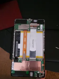

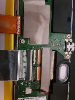

Running stock on the tablet (It's the wives so she didn't want me touching it since it was hers) so I tried to get into recovery mode, but with the screen I was unable to get anywhere on a reboot. I did manage to get the tablet apart and all the connections looked good until I moved the white cover on one connection (see picture). I believe that connections itself is solid . Tried charging the unit over night and I know it was taking a charge since I did briefly get the screen to show right one time, but it still mostly shows like on my original pic.

Sounds like parts just going bad. Could probably get it repaired, but as a fellow stock Nexus 7 owner on Lollipop....why? Could grab a 2nd generation Nexus 7 for pretty cheap.
