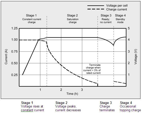

The way the charging circuit decides the battery is full is to watch the rate of current draw and voltage levels and look for a signature drop that indicates the battery is approaching maximum capacity, about 90% of maximum. Once the battery reaches that level, the charging circuitry drops the charge rate dramatically, and instead charges on a "trickle" rate and continues to charge slowly till it reaches the maximum voltage allowed, to top of the battery and assure a full charge, while preventing it from over-charging. Once the voltage hits the cutoff, charging stops completely.

Figure 1: Charge stages of lithium-ion. Li-ion is fully charged when the current drops to a predetermined level or levels out at the end of Stage 2. In lieu of trickle charge, some chargers apply a topping charge when the voltage drops to 4.05V/cell (Stage 4).

If a lithium-ion battery must be left in the charger for operational readiness, some chargers apply a brief topping charge to compensate for the small self-discharge the battery and its protective circuit consume. The charger may kick in when the open-circuit voltage drops to 4.05V/cell and turn off again at a high 4.20V/cell. Chargers made for operational readiness, or standby mode, often let the battery voltage drop to 4.00V/cell and recharge to only 4.05V/cell instead of the full 4.20V/cell. This reduces voltage-related stress and prolongs battery life."
