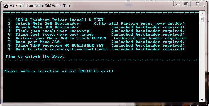

The Moto 360 is pretty developer friendly meaning that it is easily bootloader unlockable and rooted. You can do this manually if you know where to grab your files and if you know how to use adb. The Moto 360 Super Tool by developer "RootJunky" makes doing all things root super quick and easy. With the tool kit you will be able to install adb and fastboot drivers from Motorola and test them, unlock the bootloader, relock the bootloader, flash stock wear recovery, flash stock wear boot image, restore your Moto 360 to stock, root the Moto 360, flash TWRP recovery (coming soon), boot to stock recovery from bootloader mode.
In order to use this toolkit you will need a few things. You need a USB interface cable There is a video link on how to make one yourself (they are not available to buy yet). You will also need to know how to remove the watch band. Head to the link below to grab the Moto 360 Super Tool.
