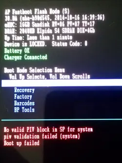

Screen shot below is the error that is received when attempting to use any of the options on the fastboot menu.
