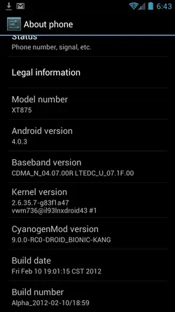

So i updated to .902 and forever rooted and all that. Then i reinstalled safestrap and installed ICS in that. Still no data. I removed safestrap and installed it as my only rom and STILL NO DATA! I really want to use ics would someone please help. Inter 'Mobile network state' it says disconnected. Screenshot_2012-02-16-18-43-11.webp
