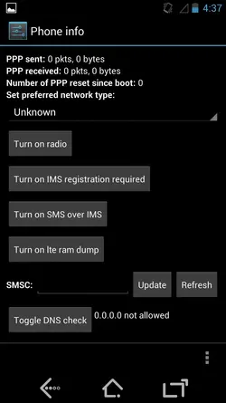

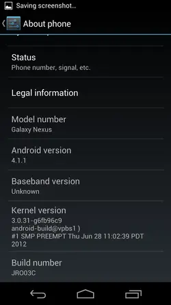

My problem is after downgrage the rom 4.1.1 to 4.0.4 and in the About - Baseband shown UNKNOW.
I ugrade back to 4.1.1 also the same thing. Please see in the pictures.

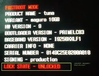

I'm a little confused. Do you actually have a maguro or did you flash the wrong images? If you have Verizon coverage, you should have flashed toro images.
I'd download the files again & check the md5. Then reflash them. Btw, how are you flashing them?
It also looks like you're asking what the "unlock" means. It basically means you can flash anything to the phone you like.

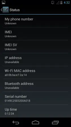

Check and see if you still have an IMEI. Settings-About Phone-Status. If you've lost your IMEI as well, this thread may help you.
PROBLEM, lost IMEI, baseband... - xda-developers

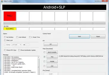

Did you already try the ODIN step in that thread I linked you to? Post #4 by macraft

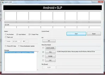

I had follow the intruction by MACRAFT to do the ODIN process but the result as:
1. No yellow screen in the ODIN program
2. In the meaage field: <OSM> All threads completed. (succeed 0 / failed 0) Please see the picture
WHAT DO I NEED THE NEXT?
