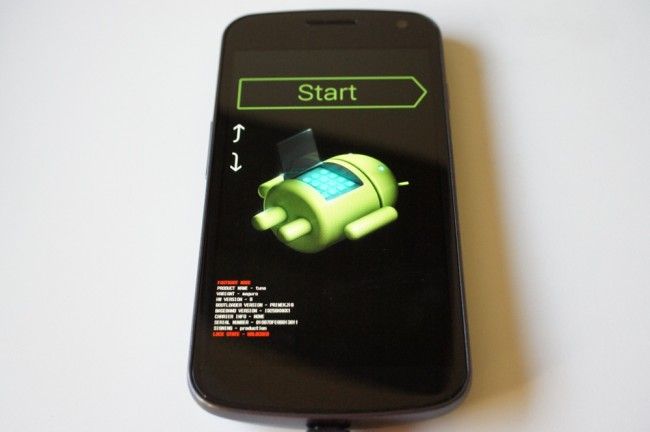

7. Type the following command:
adb reboot bootloader8. Your phone will turn off and reboot to the bootloader.

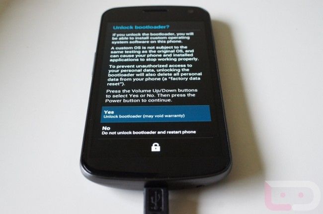

9. Type the following command:
fastboot oem unlock10. Your phone will then ask if you want to unlock.
11. Using the volume keys, highlight “Yes” and then press the power button to select it.
12. Your bootloader will now be unlocked.
