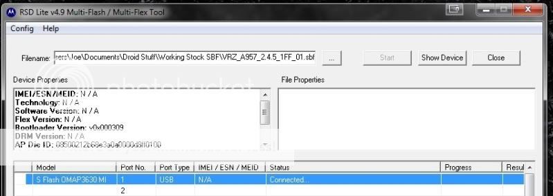

Thank you for the screenshot, it happened to be too low of resolution to read what rsd lite was displaying though. Would you mind doing another please?

I have read in forums that the greayed out issue happens in some machines if the .sbf is not in the root of the c:/ might wanna try that.
@pilotrose seems like that his phone details shows up on he phone. So if we can trick rsd lite some how to think that the phone is connected then may be it will be able to inject the .sbf in to the phone... Just a hopeful thought.. Don't even know if it is technically possible or not
I will say that when I load the sbf on there Rsd lite won't give me the option to start it is greyed out, so seems like the files are bad. Or just not for this phone.

And yes putting the sbf in the root of C: fixed the problem and the start isn't greyed out anymore.

Thanks for the updated pictures...
very interesting thing... that you have a 03.09 bootloader when both @pilotrose and mine are 03.08.... did you do the recent update?

Yeah I did the over the air update when I got it, still only had the device a few days now.

It vrey well could be any of those conclusions:
as RSD Lite only shows this when the phone is connect:
IMEI/ESN/MEID: N / A
Technology: N / A
Software Version: N / A
Flex Version: N / A
Bootloader Version: v0x000308

That would be my guess. Frankly, without seeing the IMEI or whatever I'm thinking it's RSD Lite not recognizing the phone properly so it can't program it.

as this other person with a completely working Droid Pro updated with the recent OTA sees this when connected to RSD Lite 4.9
So you know where we can seek some help regarding patch for the RSD Lite... for this kind of issue?
