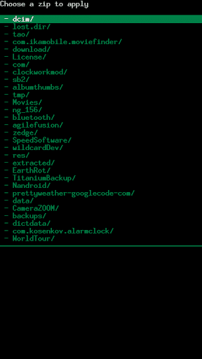

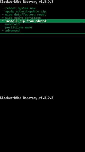

Click the option " Install zip from sdcard"
Step 5) Find and choose the file CyanogenMod 5.0.5.7 (or the Rom you chose to install)

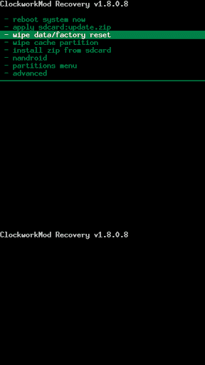

Step 6) Wipe data
Step 7)
wipe cache

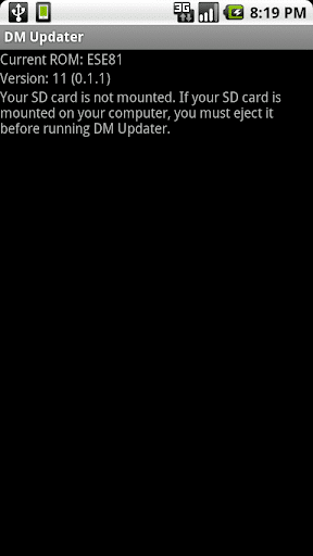

Problem 4: When trying to install the DM updater app I get the following message "Your SD card is not mounted. If your SD card is mounted on your computer, you must eject it before running DM updater".

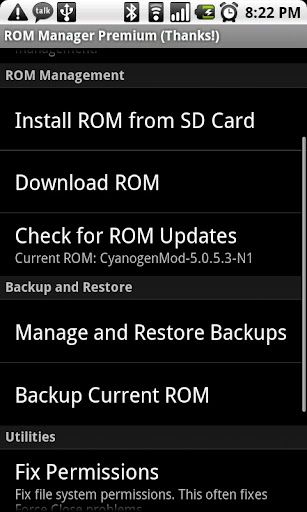

Step 1) Go into Rom manager.
Step 2) Flash Alternative Recovery image (Sprecovery)
Step 3) Boot into recovery (Power off, power on + "x")
Step 4) Scroll to and click on the Backup/ restore option
Step 5) Restore Nandroid (either simple nandroid restore latest or advanced)
- For Simple (which restores the recent backup) :
- Advanced Allows you to choose the backup to restores
- Find a choose a backup that you made
If you do not have a backup then you can install a rom from this menu.
- example. Is to install a rom with an update.zip )
- Rename it update.zip
- Mount SD card (you can do this in the recovery menu by scrolling down from the main menu to mount options, then Enable USB mass storage, then install the update.zip {update for Windows 7} to the root of the SD card {that means that it does not get installed into any folders})
-Install
- Allow Update.zip
- Install/sdcard/update.zip (depreciated)
Wipe data and Cache
-Reboot system.
You should now be able to install DM Updater.
