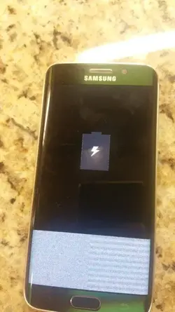

I have owned the phone since new. Was working fine, then just started doing this. Not dropped, no water issues.

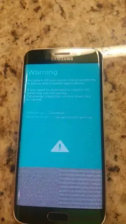

Normaly shows battery screen or flashes Samsung logo. The other screen, the custom OS screen, i can get to by holding down the up vol, power, and home buttons. I posted this pic to show that some of the phone still operates and that it is just not stuck on one screen

if plugged in it shows the battery screen and does nothing else. pic shown in first post

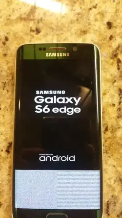

Unplugged it flashed the Samsung logo screen. Pic attached to this post
The custom OS screen, i can get to by holding down the up vol, power, and home buttons.

Did you happen to let the device's battery run down to 0% ? Also, is this an S7 or S6? The title says S7, but your post says S6. (Just noticed your last picture shows S6, so I'm assuming it's the S6)

Vol up, home, power goes to the The custom OS screen as pictured. Any button hold or press during logo does nothing. Phone just continues to flash logo on and off
