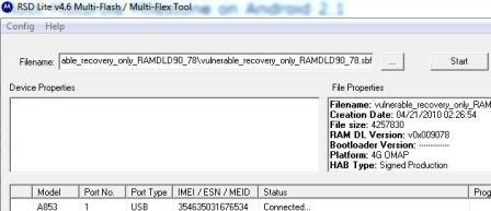

How to Root Motorola Milestone on Android 2.1
The bootload process of Motorola Milestone running on Android [COLOR=blue ! important][COLOR=blue ! important]operating [COLOR=blue ! important]system[/COLOR][/COLOR][/COLOR] version 2.0 or 2.1 has been locked down by Motorola, as the firmware for Motorola Milestone has been digitally signed by Motorola with the company’s digital signature. As the result, the process to root the Motorola Milestone is slightly more complicated, as the user will need to flash vulnerable recovery image (SBF) to Motorola Milestone to make an “unrootable” firmware to become rootable.

  6. Run RSDLite on the [COLOR=blue ! important][COLOR=blue ! important]computer[/COLOR][/COLOR].
  7. Go to the USB Connection app on the phone again, and select the mode as [COLOR=blue ! important][COLOR=blue ! important]Portal[/COLOR][/COLOR] & Tools. If the MotoConnect Moto Phone Portal or MediaLink appears, ignore and close the web page or program.
  8. In RSD Lite, the phone should be listed as “Connected”. Select the vulnerable recovery SBF file downloaded from link above, and click Start button.
    The Motorola Milestone phone will reboot automatically to bootloader mode, and start flashing the vulnerable recovery firmware. The process may take a while, and once the process is completed, the phone should start back up with RSD Lite showing a “Finished” and/or “PASS” status.
