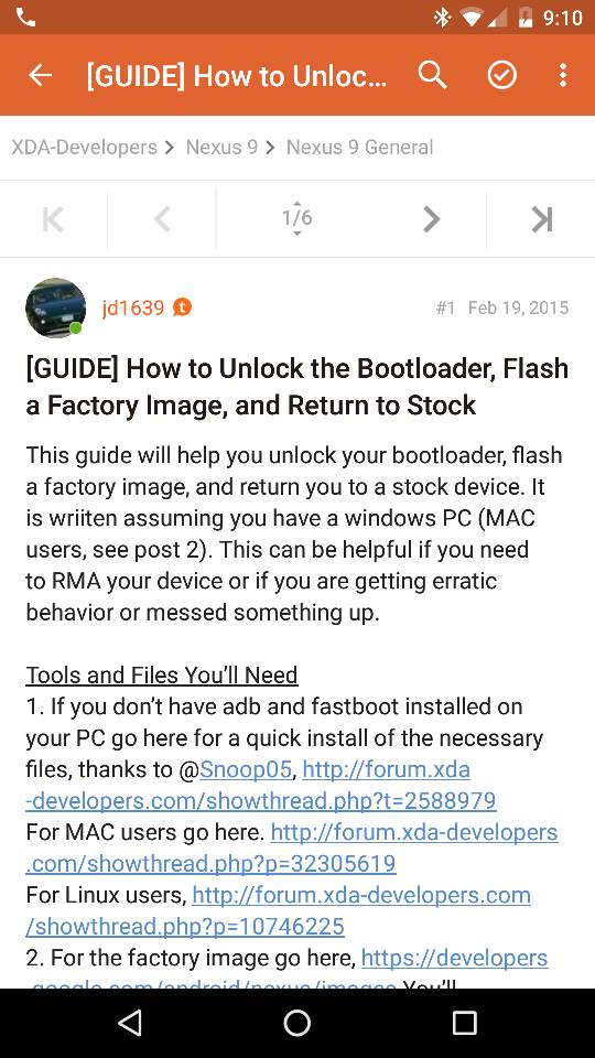

Unlocking the bootloader on the N9 is a multi-step operation. You have to activate the Settings->Developers Options menu, and enable USB debugging and bootloader unlocking on the tablet with menu picks under Developer Options while it is booted to its ROM. You then boot it to the bootloader and issue the fastboot command to unlock the bootloader.
I highly recommend that you check out [GUIDE] How to Unlock the Bootloader, Flash a Factory Image, and Return to Stock before you try again once you've received your tablet back from HTC.
Good luck!

Anyway, the main point of my post to you is that if you cannot boot to the ROM then you cannot unlock the bootloader. Period. That is why you're stuck until you receive you tablet back from HTC when, supposedly, it will boot. Then you can start again by trying the link, which I'm re-posting here without the link "helper" that's in the forum interface: [GUIDE] How to Unlock the Bootloader, Flash a Factory Image, and Return to Stock
