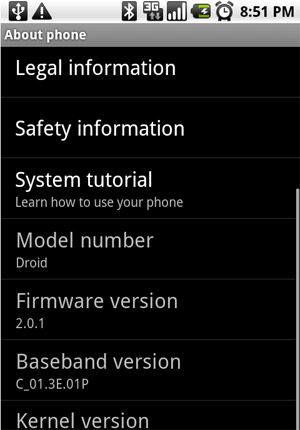

Below are the instrcutions for applying 2.0.1 manually without waiting for OTA Update.
  • Grab this file https://android.clients.google.com/upda ... 263456.zip
  • Rename the file to update.zip and place it the root directory of your SD Card.
  • Power off the phone.
  • Power on the phone, while holding the 'X' on the physical keyboard.
  • When you see the triangle and !, press Volume Up + Camera button.
  • Navigate to "apply update.zip" and press the gold button (center) on the D-Pad. Now it will install.
  • Reboot phone (should take 3-4 minutes).
Your DROID is now running 2.0.1 instantly without waiting.
