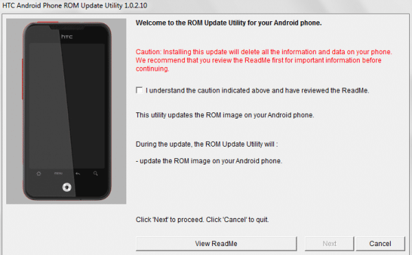

Only hours after our source dropped a 9/1 Froyo release bomb for the Droid Incredible (then retracted it), a full Android 2.2 leak snuck into the wild. And we aren’t talking about some simple nandroid ROM, we’re talking an RUU which is like an SBF file in HTC land.
We’re still in the process of flashing this to our own DI and will let you know as soon as we have finished, but really you just need to understand that this is big news. And maybe our jittery source wasn’t so wrong after all?

We’ve had a chance to flash the new (and what appears to be official) Android 2.2 for the Droid Incredible and wanted to drop the instructions on you.
*Warning*
– For those that aren’t rooted, the steps are pretty simple (read Note 2), just understand that this will wipe your phone completely clean meaning all of your apps will be gone and you’ll need to set up your accounts/settings again. Also be warned that if this is not the official update, it could be extremely difficult to back out of and OTA updates could pass you by. Don’t say I didn’t warn you. You accept all risk involved.
Instructions: (pulled from XDA and edited)
*Note 1* – If you are rooted, make sure you have flashed the unrevoked-forever file!
*Note 2* - If you just want to update to 2.2 without root, just plug your phone in and run the RUU which you can download from here.
