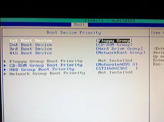

ive been thinking about this alot lately becouse it would come in handy so i figured i would give something a try and i have had slight success.
i formated my sd card used unetbootin to setup the directory structure just like a bootable usb thumb drive would be.
first i tried mounting sdcard using sprecovery and booting from it. i noticed that the device had changed in bios from "Motorola A855"(already recognized as a cdrom drive. see attachment) to "Generic MC" booting was a failure.
Second i tried mounting sd card with the android os running. first problem i encountered was that when u restart your computer it shuts off the power to the usb ports making the phone think you unplugged the cord hence android os auto mounts sdcard. after many restarts i tried to time it just right so it recognized it as a bootable device. i was successful only once and managed to boot into a Linux live cd.
progress is progress i guess any ideas?
