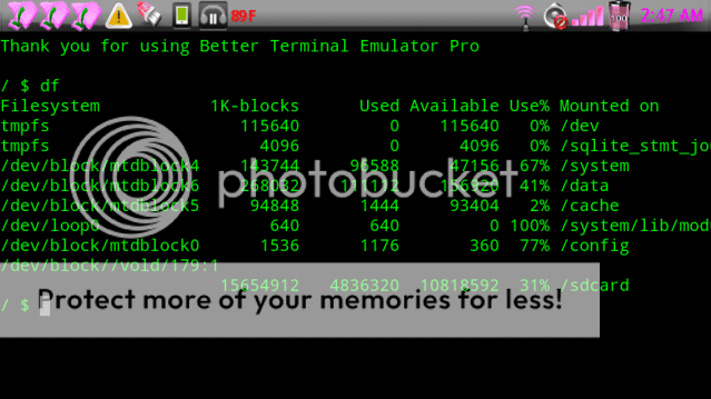

Thanks Chris...i did the df thing and here's what it says....as if i can understand it lol

Apps in /system/app are your default applications that come with the phone. Anything else thats there have been physically put there by the dev or you. Internal phone storage is only /data I am like 99% sure. You can have a lot of internal phone storage, but go to adb push an app to /system/app and get the error: "Not enough space left on device". I've seen it a bunch of times. That's because /system will not be reported as "internal" phone storage because you're not supposed to be adding/removing things from there anyways technically, so that's not even taken into consideration with "internal phone storage".
And also, flashing ROMs doesn't have anything to do with the amount of space left in /system. And this is because, when you're flashing a new ROM, what's happening, is the /system partition is simply being switched out for a new /system partition. Doesn't matter if /system was completely jam packed, the *entire* /system is removed, and replaced with a whole new /system partition.
