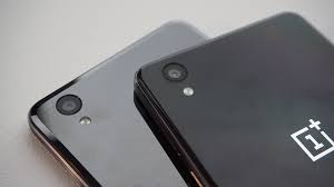

The OnePlus X is the mid range device from the makers of the "Flagship Killer" series. Surprisingly the OnePlus X is getting rave reviews, and is being touted as the best "Bang For Your Buck" device for 2015. I have yet to get my hands on the device, but it looks pretty amazing at the price point. This phone is basically a lower end smaller OnePlus 2!
