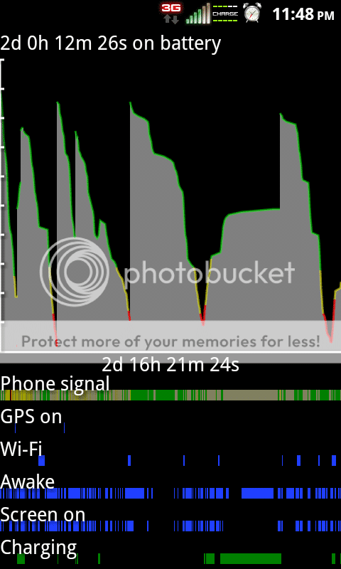

    Update-
    Still cannot charge to 100% and the battery has been thru roughly 8 cycles. I ordered an external wall charger, so hopefully that charges the battery to 100%, then I can pop it in the phone at 100% and calibrate the battery.
    Any ideas why my battery reporting looks like this:
    [​IMG]
    It appears the stats aren't resetting when its plugged in...?
