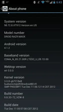

My question is those of us who's phones did successfully update on this leak, will we be able to update once the final update comes out?

I'm sure they know who got the actual OTA, they would have to make things right for those folks. Those who got it from another source will have to wait till some Dev works their magic or FXZ file gets leaked. I guess.
You will have to use 1.82 utility to flash back to .211 and then you will be able to update. Otherwise you cannot. It is quite easy though :)
(just download the file when you have the time it is huge and takes a long time)
I hear, according to Matt, who built the utility, it will not work to get you back from this update.
I suspect there will be a way, but i don't think there is now.
RAZR MAXX
I was not aware of this :O. Sorry D:
