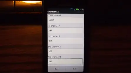

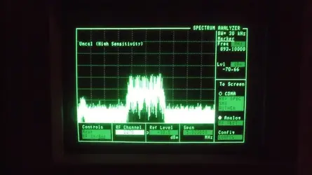

I wonder to what advantage VZW would have if they did this?
We activate and reactivate older Android devices like the weather, and have yet to be prohibited, but then again, we are comparing apples to crab cakes here.
With VZW being CDMA and if I remember correctly, an 850/1900 band plan, a quad band phone that is already on an active CDMA system should be allowed to port over.
I mean, I ported over Straight Talk handsets to VZW, and this is no different.

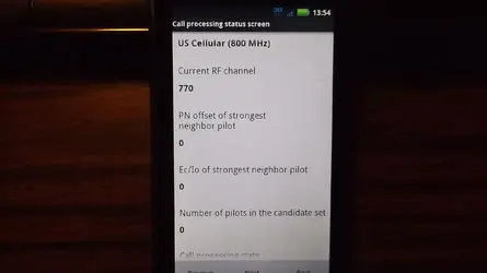

One could check the baseband version, then check out the test mode to see the actual HDR channel is, the UATI color code is and active 1st and 2nd channel A/B numbers are active, such as 283/384, 691/777 and the reverse channels of these.
This is a shot of an active CDMA channel (2270).

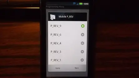

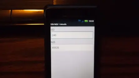

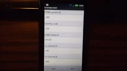

This is my system information for VZW networks in my area, and due to reuse, these are probably identical across the nation, altering the SID/NID according to service area/licensing requirements.

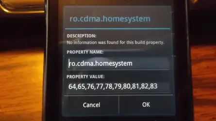

Home system.
