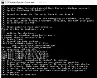

I am unable to root after JB OTA Update to 4.1.1
Process followed by results below:
1. Download and extract the entire zip file. (http://vulnfactory.org/public/motofail2go_windows.zip)
Download this: http://www.aosp.us/wp-content/files/Root.zip
Inside the folders you will find su.apk and superuser.apk. Copy and replace the ones that came in the original post with these two apks here.
2. Ensure your device is connected via USB and that you have installed the latest ADB drivers from Motorola.
3. Double-click "run.bat" and FOLLOW THE INSTRUCTIONS. The exploit will ask you to press a button combination at one point.
1st Screen:
Failure [INSTALL_FAILED_UID_CHANGED]
"Volume Up + Power simultaneously" does not appear to "trigger bugreport"
"vibration" is just the ringer volume increasing.
Holding VolumeUp+Power for 5/10/15-seconds has same effect (no distinct vibration noticed).
2nd Screen:
3rd Screen:
Exploit failed
failure
Exploit complete!
Press any key to ... (phone reboots)
Results:
No Superuser.apk installed and effetivley no root effect that I can see.
I have also attempted using the original motofail2go_windows.zip without the changed Superuser.apk & SU-file (same results as illustrated above).
Any advice would be appreciated,

I believe the answer has been staring me in the face since the 1st Screen. Interestingly, the line directly preceding where I could not trigger a bug report. Ran around to all kinds of forums looking for answers to "others" problems, that I did not spend the time to simply interpet the code of my own issue - duh! Been too busy/lazy to factory reset the device (partily because, can not get Titanium Back up loaded 'cause phones not rooted), partly because I started using the device to experiment with un-rooted JB pre root to see if I wanted to stay JB or go back to ICS and wait for JB 4.2.
So, my money is on I should have rooted freshly after the OTA push of JB when the device was fresh. Now need to back-up my stuff then reset, then apply root process.
