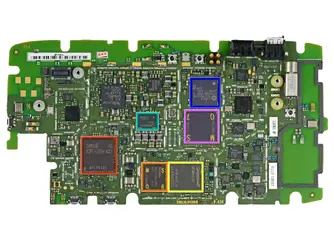

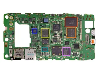

I would strongly frown upon flashing the ROM for a Droid RAZR into a D4 or vice versa, and for that matter the ROM from ANY phone onto ANY other, unless you are absolutely sure the Kernel is compatible. They are NOT the same phone, no matter if they seemingly act the same. The D4 has a keyboard and that means a whole section of the Kernel devoted to managing the digital feedback from that keyboard. Not to mention the architecture of the motherboard is different. Sure it may have the same processor and memory and even the same GPU, but that's where the similarities end.
Think of it this way...
We can make an Android phone look, feel and operate just like an Apple iPhone (except perhaps the snappy GUI of the Apple iPhone due to its highly integrated OS and hardware), and perhaps even vice versa, but that doesn't mean that you can flash an OS 10 on to a Droid RAZR, nor can you flash a Android 4.01 onto the Apple iPhone.
Droid 4 motherboard (click to enlarge):
http://www.ifixit.com/Teardown/Motorola+Droid+4+Teardown/7759/2
Droid RAZR motherboard (click to enlarge):
http://www.ifixit.com/Teardown/Motorola+Droid+RAZR+Teardown/7048/3
Images courtesy of ifixit.com
