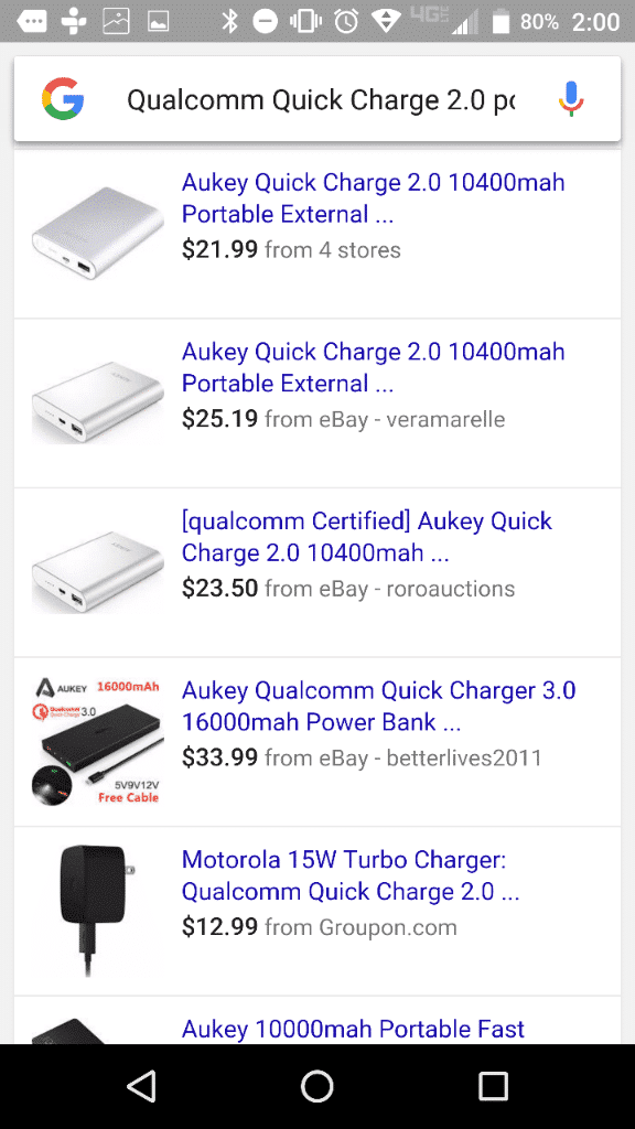

    OK, you're not finding what you're looking for because they're not identified that way. Search the following;
    "Qualcomm Quick Charge 2.0 portable cellphone charger -solar"
    Then select the "Shopping" tab.
    Quick Charge 2.0 is by its very nature a 15 watt (3A) charging system. Any charger that adheres to the Qualcomm Quick Charge 2.0 protocol will charge with up to 3 Amps of current. Amps times Volts =Watts. So, 5 Volts at 3 Amps provides 15 Watts of power.
    [​IMG][​IMG][​IMG]

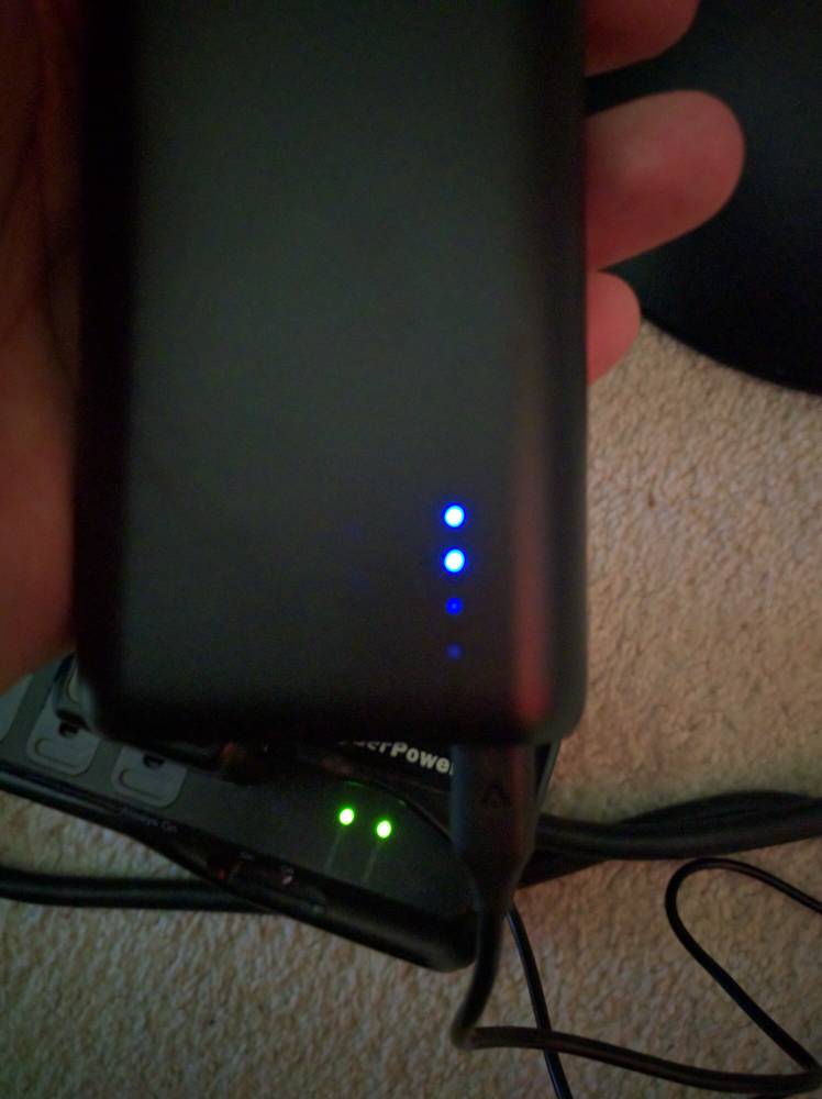

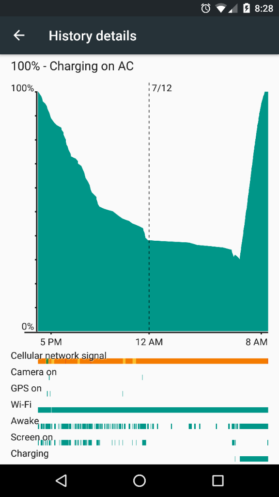

    I bought this one.
    Anker 20000mAh Portable Charger PowerCore 20100 - Ultra High Capacity Power Bank with 4.8A Output, PowerIQ Technology for iPhone, iPad & Samsung Galaxy & More - Black https://www.amazon.com/dp/B00X5RV14Y/ref=cm_sw_r_cp_apa_pmoHxbNP4K76V
    It never registered "rapid charging" but it took me from 50% to 100% in about an hour and a half.
    [​IMG][​IMG]

    That's some fast charging for sure. The specs show a max charging rate of 4.8A, but that is a combined maximum across all ports. I wonder what the maximum current is to any single port. It did not specify.

    I can't tell either. I can't imagine 4.8a per port.

    So I either have a dud or a really slow charger. [​IMG]
    Been flashing Two LEDs for almost 10 hours.
