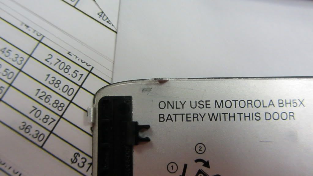

    I was having this same problem as the OP about a year ago and found a thread with a solution that worked for me and many others but does not seem to work for everyone but it is simple and worth a try.
    Take off the battery cover and place a piece of tape on the back cover where a pin from the main case next to the battery touches and battery cover.
    Pics below show the are i am talking about and if you look at the back cover carefully you can see the tape over the scratch on the back cover caused by the gold pin in the other picture next to the battery release tab.

    Quote Originally Posted by schatzy62 View Post
    I'm sorry but how exactly does a piece of tape on the inside of the battery door effect GPS performance at all? I don't wanna sound rude here but I'm having a hard time believing that

    The battery cover is anodized aluminum and as such is not a great conductor. During removal and replacement the anodize surface is worn thru by the small gold pin and when it finally meets the raw aluminum (which is a fairly good conductor) it acts as a ground plane and reduces the GPS signal to the GPS antenna. This reduction in signal makes it a lot harder for the GPS receiver to "lock on" to the satellites. So it takes a lot longer for the GPS receiver to come to be usable.
    I have tested the signal strength with and with out the tape is place and there is a 37% reduction in the signal without the tape on my phone. Others have been in the range of 5% to 40% reduction.
    Thanks for the explanation, I always thought it was plastic
